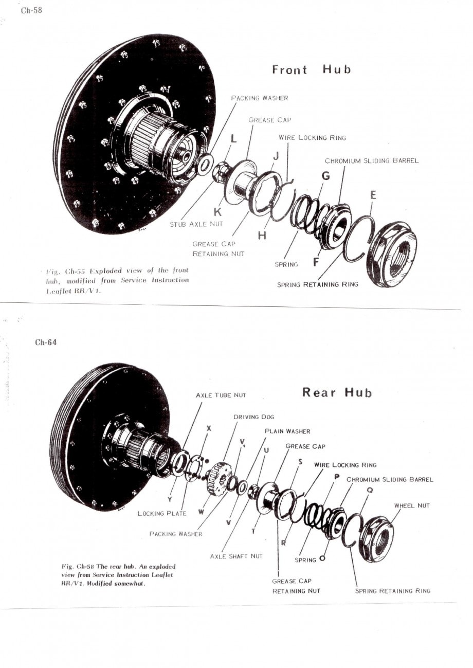

To inspect the condition of the brakes the hubs should be removed by the following procedures:

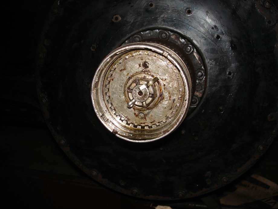

1. Front and Rear wheels Image wheel-bearings-05
1.1 Jack up the car and support securely on axle stands.
1.2 Remove the Dunlop wheels in accordance with the procedure in the Handbook.

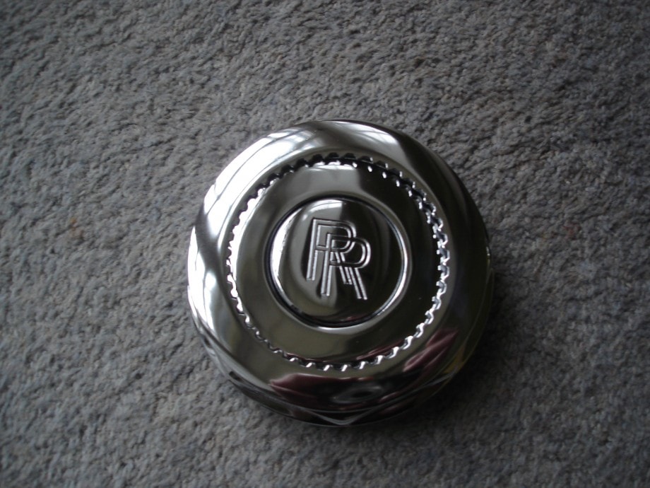

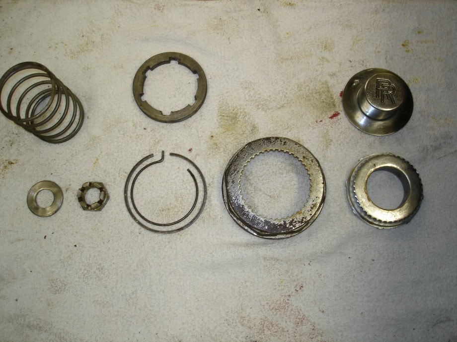

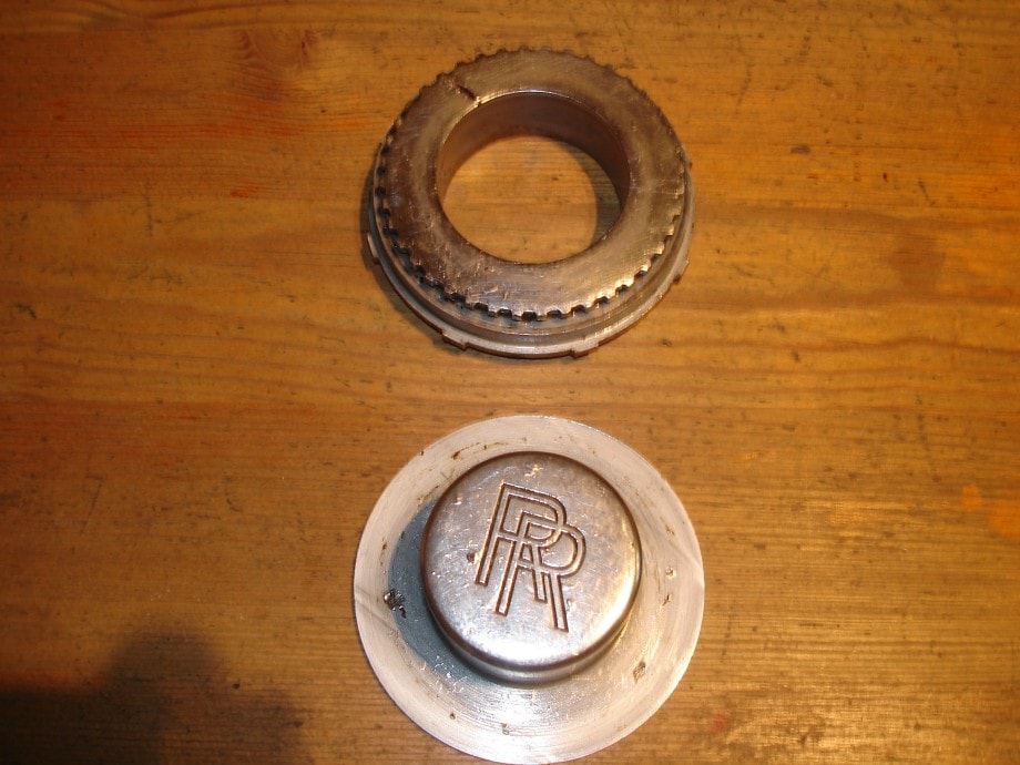

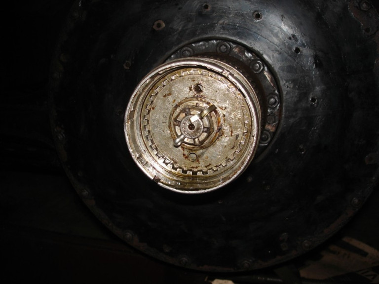

1.3 Depress the ‘top hat’ Grease Cap (with R-R logo). This is best done with a special tool, but can be done without if care is taken. Image wheel-bearings-06
1.4Prise out the Spring Retaining Ring by means of a screwdriver inserted in one of the two slots in the hub. Note: Take care when releasing the helical spring behind.
1.5Remove the chrome plated Sliding Barrel
1.6Prise out the inner split spring steel wire Locking Ring from inside the grease cap retaining nut

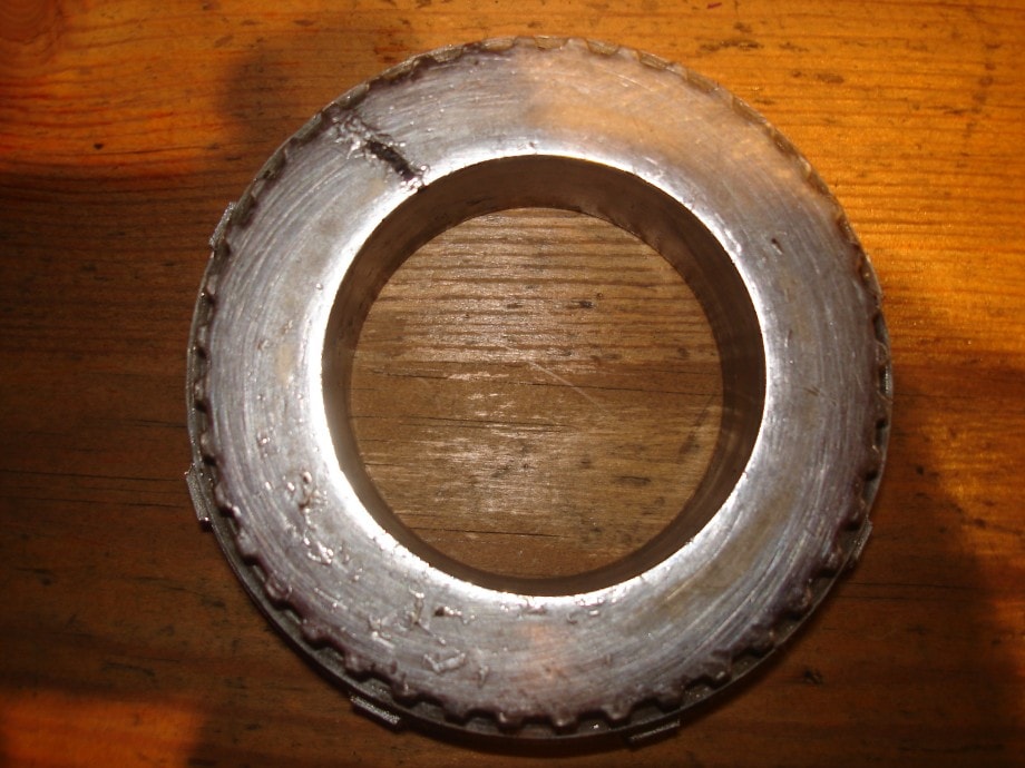

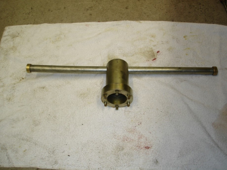

1.7Remove the Grease Cap Retaining Nut, using a special tool. (Look for RH or LH to determine whether Right or Left hand thread )
Image wheel-bearings-07
1.8Remove the Grease Cap.

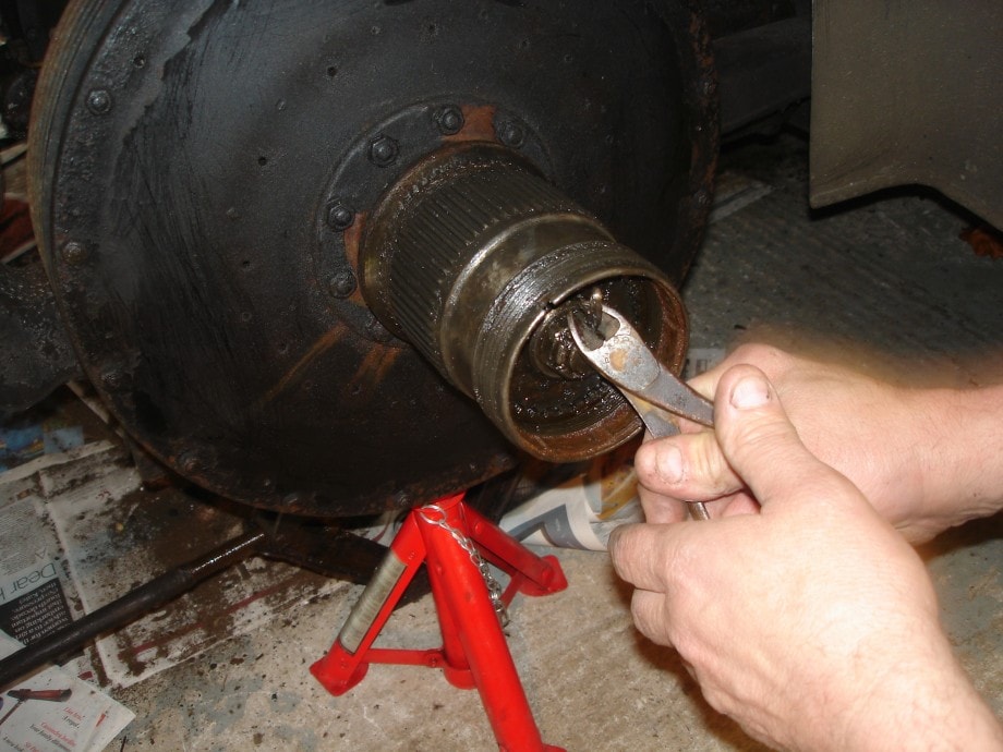

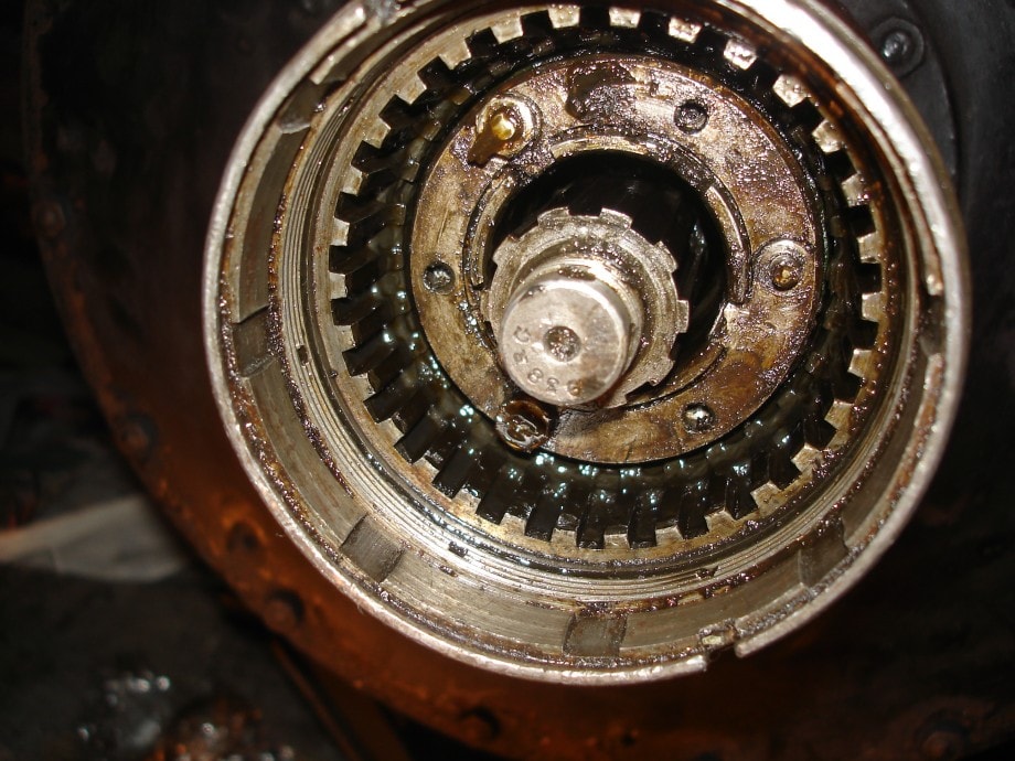

  1. Remove split pin from central axle shaft nut on the half shaft. Image wheel-bearings-10
  1. Undo and remove this castellated nut (11/16 BSF, 5/8 BSW) with the appropriate socket (Right hand thread on both sides) Image wheel-bearings-11
3.6Remove shouldered washer and plain washer behind.

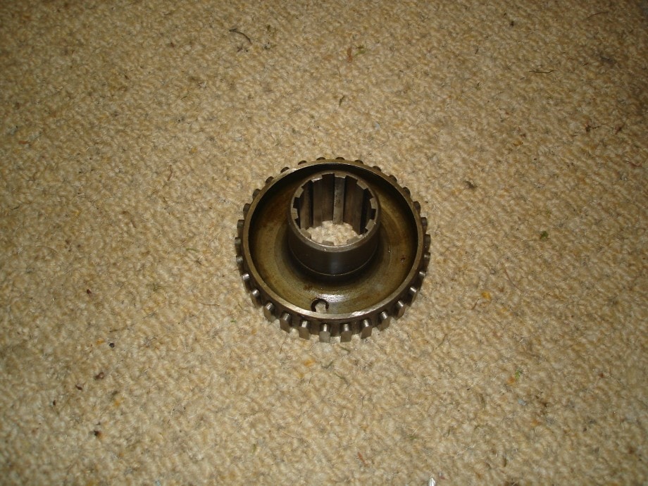

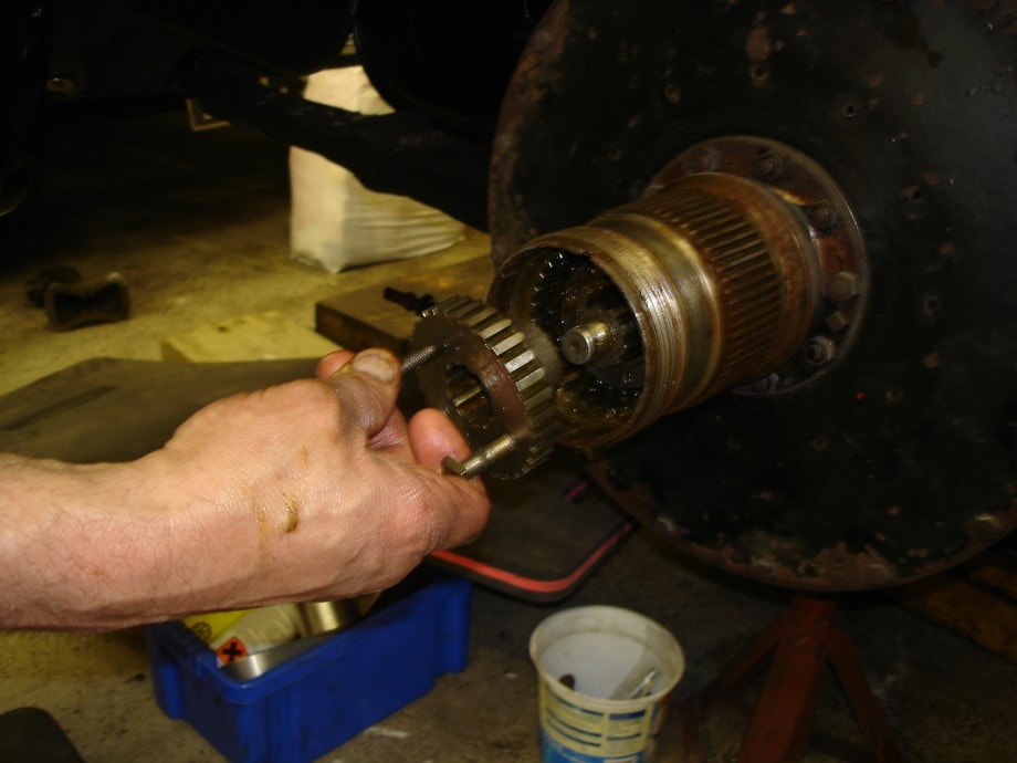

3.7Screw 2 x ¼ BSF bolts or special puller into tapped holes in ‘driving dog’.
3.8Withdraw the Driving Dog Images wheel-bearings-12 & wheel-bearings-13
The half shaft is now unsupported within the hub housing Image wheel-bearings-14

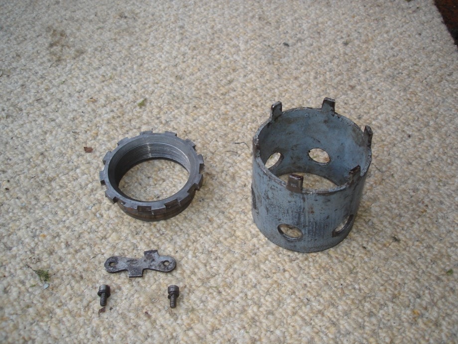

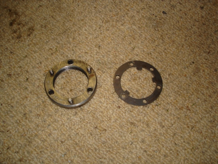

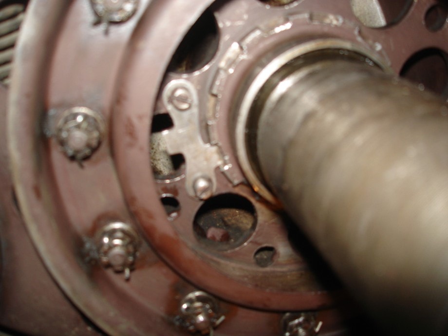

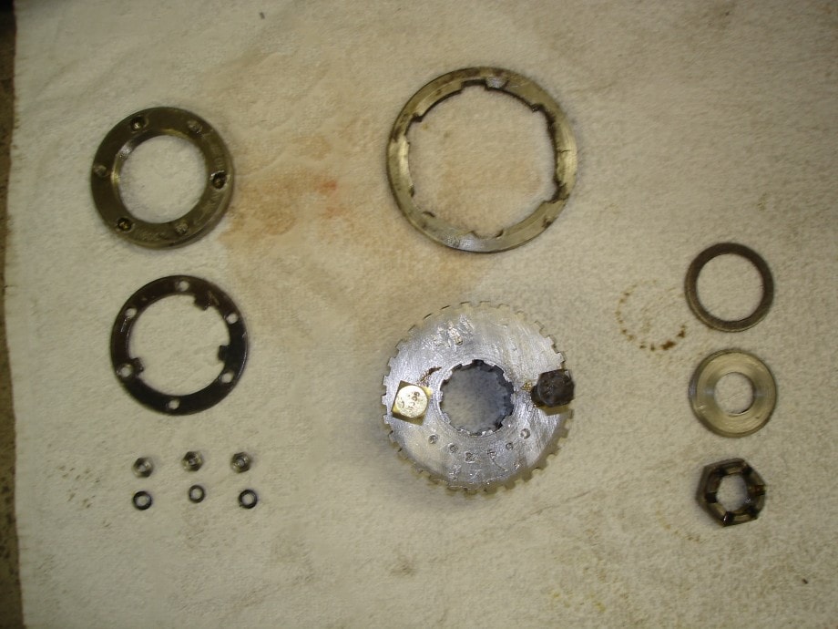

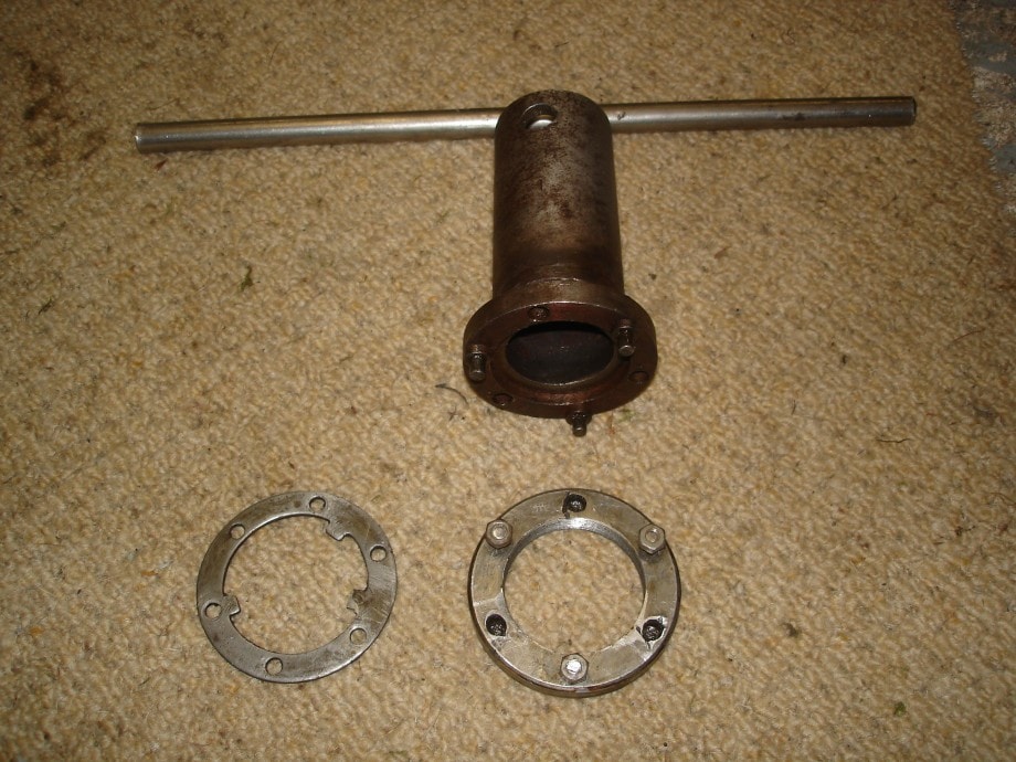

3.9Remove 3 x 2BA nuts and spring washers holding Locking Plate to the Axle Tube Nut. Note: A 3/16 BSF socket can be used for this. Image wheel-bearings-15
3.10 Withdraw Locking Plate

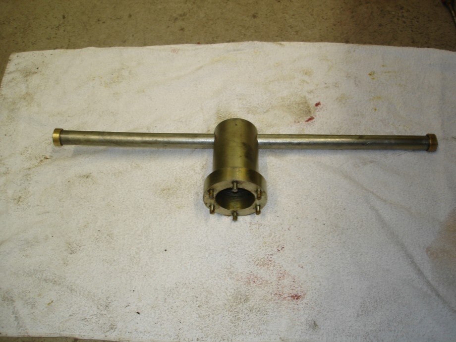

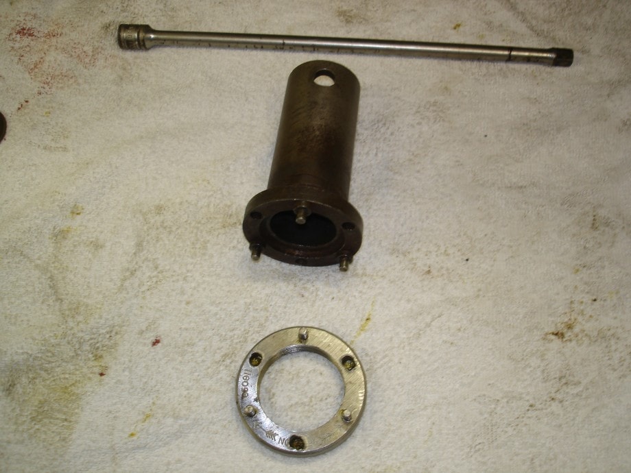

3.11 Unscrew the Axle Tube Nut with the special spanner. Image wheel-bearings-16
Notes:- the thread is Right hand on the Off side and Left hand on the Near side

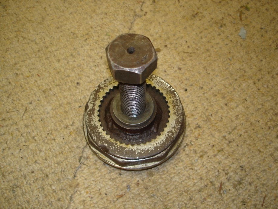

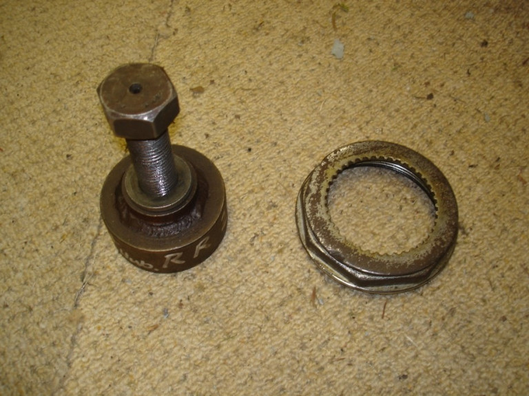

– If a correct hub puller is not available it is possible to contrive one as per images 005 and 006, which involves using a ‘dummy’ or spare wheel nut with a puller behind it.
3.12 Locate a hub puller behind a dummy wheel nut and screw onto axle
3.13 Tighten hexagon nut in centre of puller to draw off the hub, complete with brake drum and bearings. Images wheel-bearings-17 & wheel-bearings-18

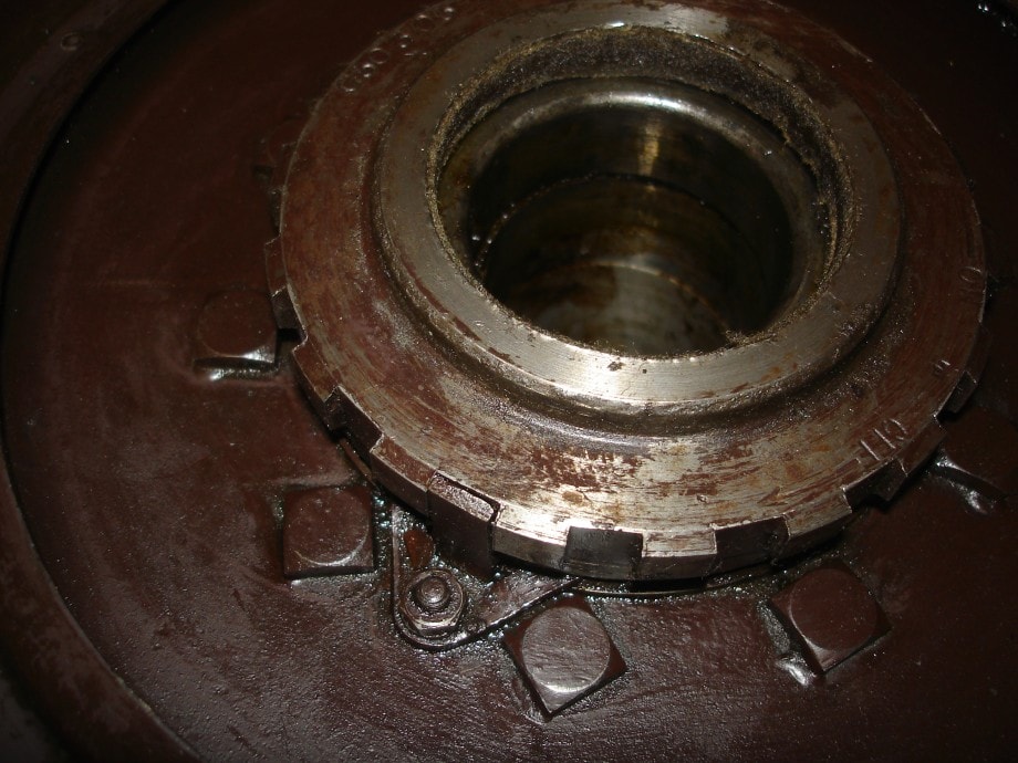

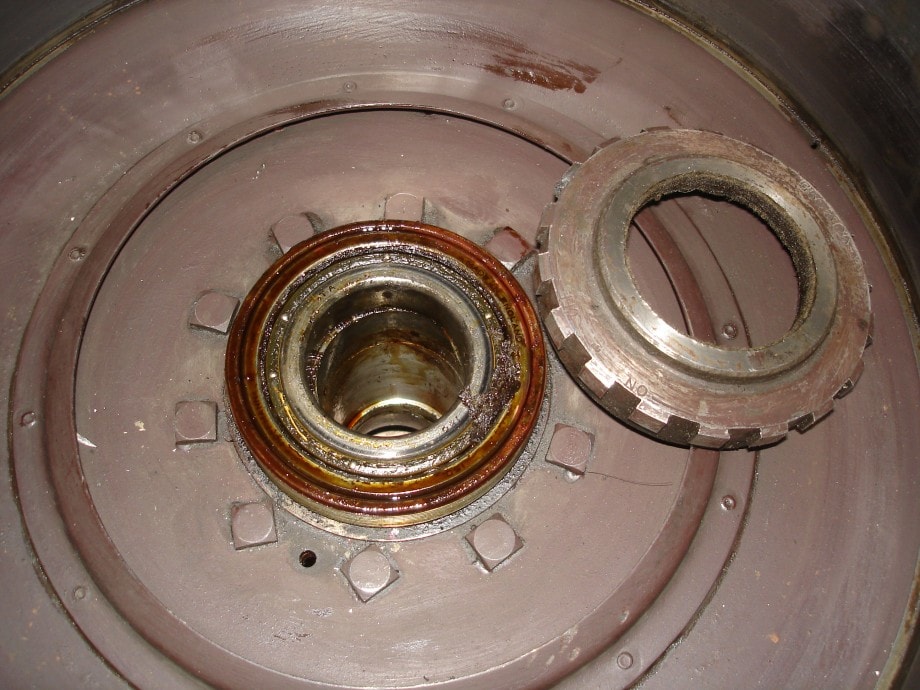

4.1 Remove the locking tab and unscrew the Bearing Retaining Nut of the inboard race, which can then be knocked out.  Images wheel-bearings-22 & wheel-bearings-23
4.2 Remove the distance piece between the bearings and knock out the outboard bearing.
Note: The retaining nut thread is Right hand on the Off side and Left hand on the Near side.

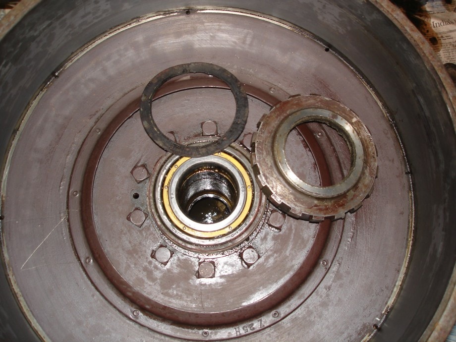

5 Rear Hub Bearing replacement
Having cleaned all parts, steps can be taken to reassemble and replace the assembly. If sealed bearings are used it becomes a comparatively clean job to carry out.
Image wheel-bearings-24
5.1Stand the hub on its end on a wooden or cardboard surface with the drum uppermost. Lightly grease or oil the inner casing.
Note: The hub is machined from a comparatively soft steel and the end is easily damaged if mishandled or placed unprotected on a hard surface.
5.2 Insert the outboard (smaller) bearing and gently lower into position. With a soft aluminium, or similar, drift tap around the outer race until it seats on the ledge.
5.3 Insert the tubular distance piece (spacer) with the flange uppermost.
5.4 Insert the inboard (larger) bearing which needs to be a snug fit so that there is no risk of the outer race rotating in its housing.
Note: If there is any doubt, a mild Loctite can be used around the housing and allowed to set in warm conditions.
5.5 The large Bearing Retaining Nut with its serrated periphery, complete with its hard composition washer should now be screwed down very tightly to firmly grip the outer race of the bearing. (Right hand thread on Off-side and Left hand on the Near-side).
Image wheel-bearings-25
5.6 Lock it into position with the tab which is retained by a small square headed 2BA bolt, spring washer and nut.
Notes: The inner races of both inboard and outboard bearings are clamped firmly to the rotating assembly by the Axle Tube Nut and distance piece.
The inboard bearing Outer race is clamped by the Bearing Retaining Nut with its composition washer and must not rotate within its housing.
The outer race of the outboard bearing is the ‘floating’ one which can move axially in service.

6.4 Introduce the ‘axle tube nut’ (a ring having three studs and three holes)
6.5 Tighten with the special tool with a 15 to 18 inch Tommy bar. (Off side Right hand and Near side Left hand threads). This is the only nut on the rear axle which needs to be really tight .
Hint: In order to apply sufficient torque, the drum needs to be secure. Place an axle stand below the drum and gently lower the jack so that the drum rests on the stand and thus prevents it turning during the tightening process.
The axle tube nut must clamp the two bearing inner races and the distance piece into a ‘rock-solid’ assembly against the end of the collar nut incorporating the inner race for the felt seal. It is the outer race of the outer (smaller) bearing which is the only one which ‘floats’ in its housing.
6.6 When it is firmly in place fit the ‘locking plate’. (This ring has more than one possible orientation to help locate the best positioned tabs)
6.7 Fix the three 2 BA retaining nuts and spring washers (preferably new ones) onto the studs.

6.9 Insert the Grease Cap and then the circular Grease Cap Retaining Nut. LH or RH will be stamped on it to indicate direction for tightening.
Note: On my car the Front Off side hub was fitted with a Left hand nut which suggests that the hubs have been accidentally interchanged at some time in the past?
There are a series of holes around the perimeter of both the Nut and the Hub into which it is screwed. Tighten until one pair nearly coincide and then nip up to align.
6.10 The Wire Locking Ring can then be inserted with its tail locating through the holes to act as a locking device.

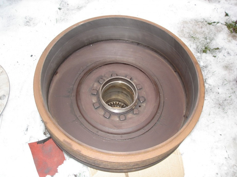

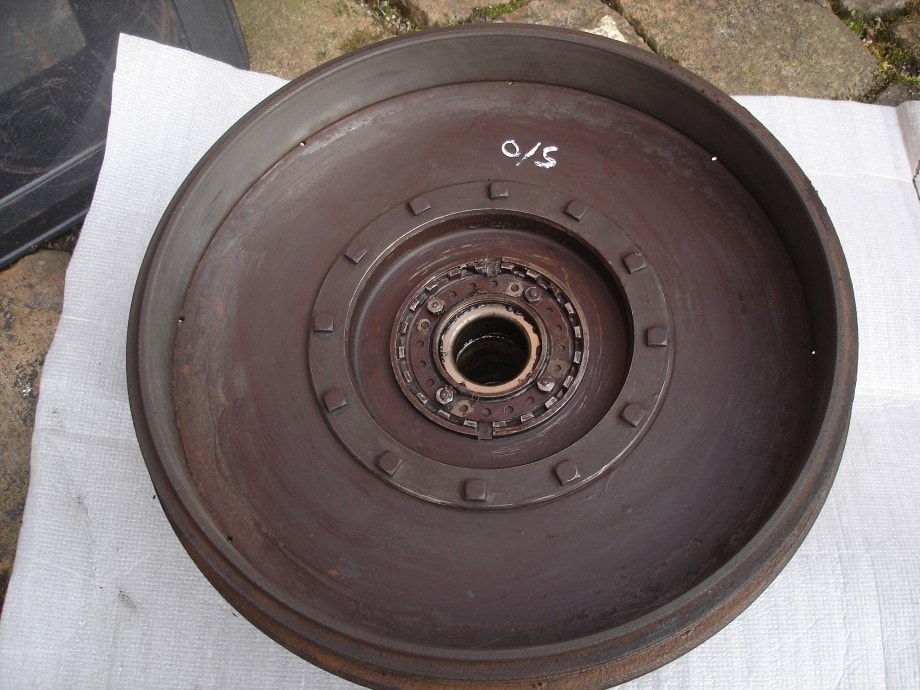

7. Brake Drums
The massive finned iron brake drums provide exceptional braking effect for the period, if kept in good order. The handbrake shoes act on the inner section of the drums, separately from the footbrake.
When the hubs have been removed give the drums a good clean and ensure the two rows of small diameter drain holes are clear. These drain any ingress of oil from the differential which may flow to the hub as a result of the car leaning at an acute angle.
If the braking surfaces inside the drum do not need regrinding it is good practice to roughen them with emery to a cross-hatch pattern and clean thoroughly with a solvent.

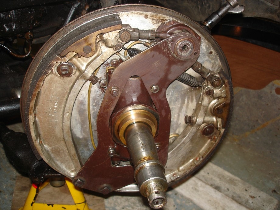

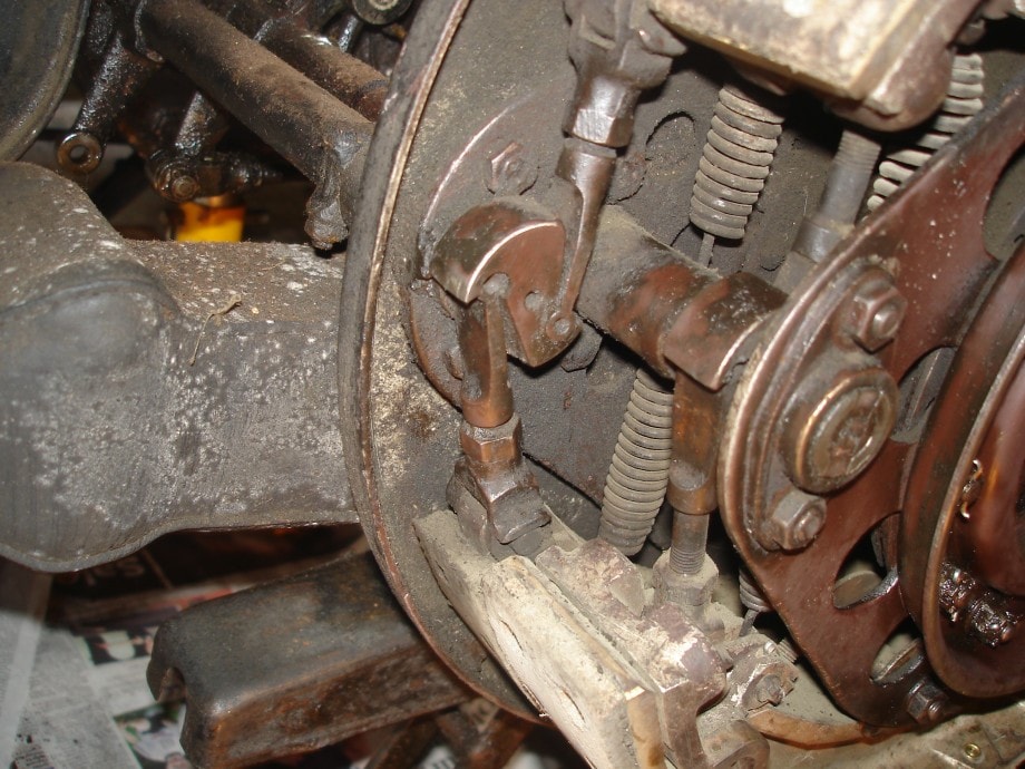

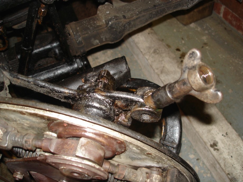

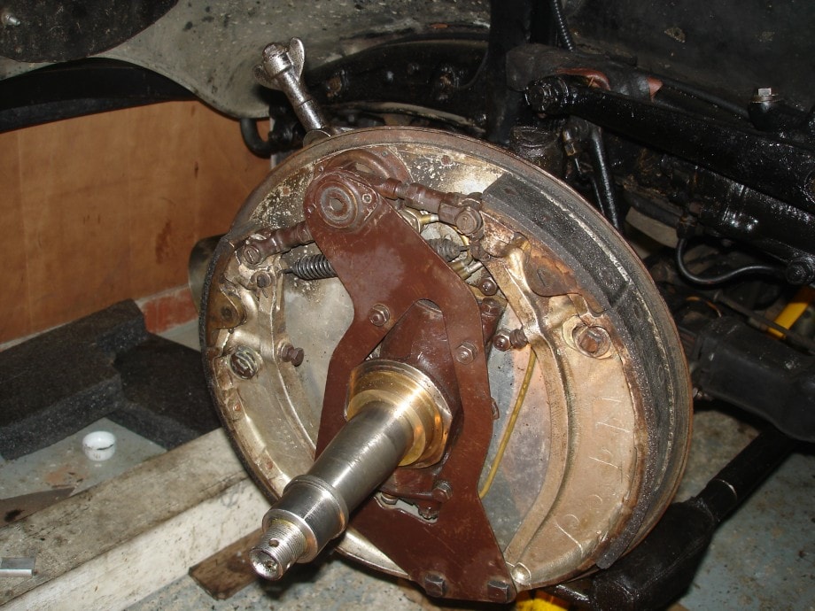

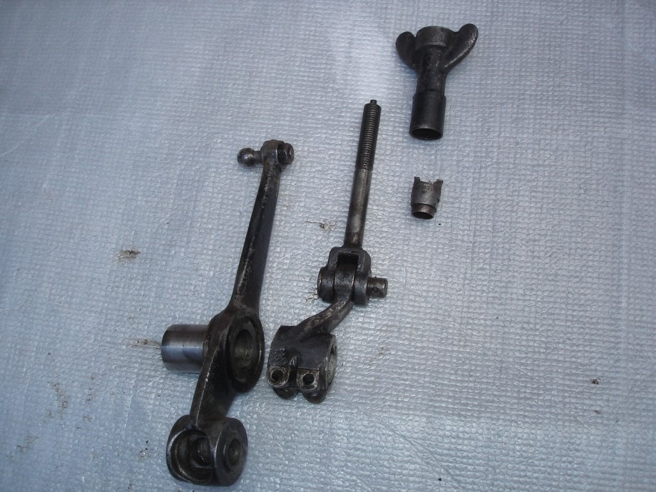

9.0 Brake adjusting linkages (front)
Some of the pivot points on the front actuating and adjusting system are not lubricated by the central system and can become seized after many years, especially if not regularly used and oiled. It is then impossible to adjust the brakes with the turnbuckle wing-nut which should turn by finger pressure alone.
In my car, the front offside linkages were free but the near side seriously seized.
Undo the two clamping screws, 3/16 BSF, on the inside boss which is located by a key.

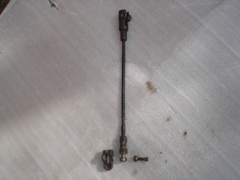

Remove the leather boot from the top of the vertical rod and separate the ball joint at end of lever from the rod.
If unseized it should be possible to slide the assembly of levers and adjusting mechanism off the stub shaft.
In my case the components were seriously seized and only freed by heating the boss to redheat by a methylacetylene-propadiene (MAPPS) torch to expand it sufficiently to drive it off the stub shaft.
After removal the parts were cleaned and mating surfaces treated with fine (400) emery paper before greasing and re-assembly.
Tip: Use a grease containing molybdenum disulphide which will continue to lubricate even when the grease itself has dried out.
Image wheel-bearings-29
The leather boots at top and bottom of each vertical rod were removed, ball joints cleaned and re-assembled with fresh grease. Image wheel-bearings-30
