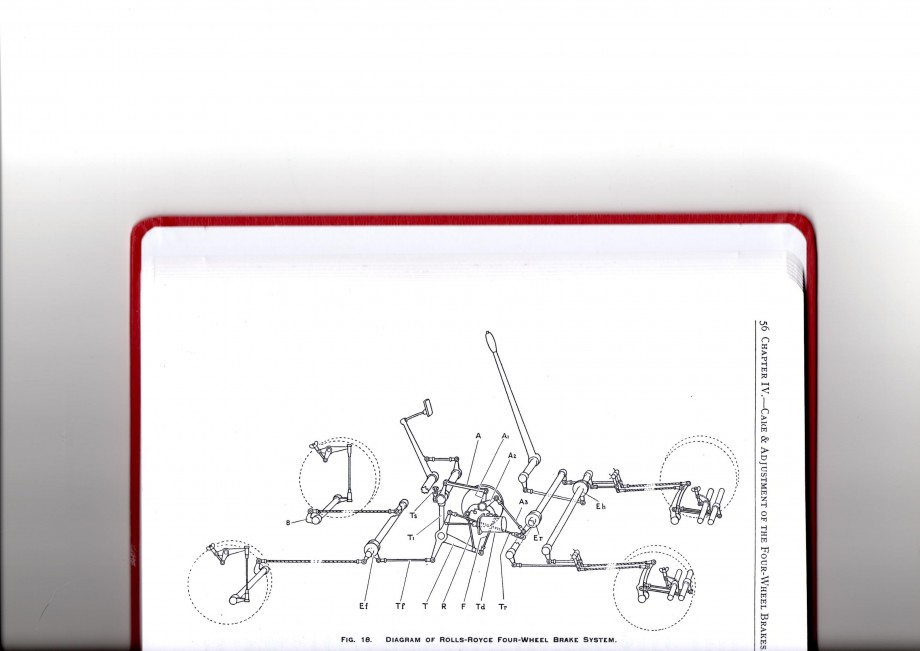

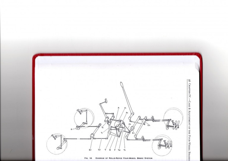

The servo system is driven via a worm gear from the output shaft of the gearbox to provide braking assistance which is directly proportional to the speed of the car. This assistance supplements the driver’s efforts in applying the rear brakes and provides the only braking effort for the front brakes. It is said by some that it therefore provides an anticipation of modern traction control. i.e. If the rear brakes should lock up during a skid, the servo stalls and automatically releases the front brakes to restore full steering control to the driver. It only reapplies front wheel braking once traction is restored.

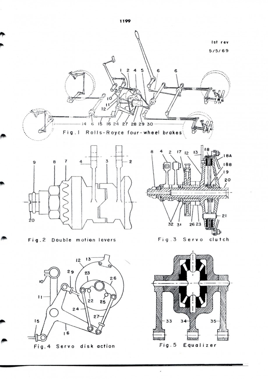

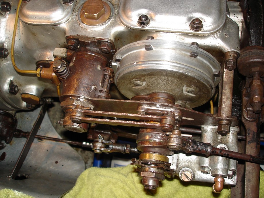

Operation and maintenance
See: Handbook Fig. ‘The Servo Motor and its Connections’ Fig. brake-servo-02.jpg
Although the system looks inordinately complex on first examination, it has proved robust and reliable in operation over many years, provided the linkages and pivots are kept well lubricated. The Servo drum rotates whenever the rear wheels are turning, anticlockwise when in forward drive and clockwise when in reverse. The Coupling Rods are labelled accordingly ‘F’ and ‘R’.
Applying the footbrake forces A1 and A2 apart which brings the friction linings in the driven plates in contact with a rotating disc within the drum in an action not unlike a disk brake. ‘R’ or ‘F’ is raised according to the direction in which the plate revolves. In both cases the arm of lever ‘T’ is lifted, applying front brakes through link ‘Tf’ and assisting rear brakes through rod ‘Tr’.
This may be better understood by looking at Fig.1 and Fig.4 in this set. Light pressure on the brake pedal pulls link ‘1’ and rotates lever 2 (A1) taking lever 4 (A2) with it. This directly applies rear brakes via equaliser ’6’.
Note: The Equaliser resembles a bevel gear differential. ( see Fig. 5)
Further pressure rotates levers 23 or 26 and raises 16 (T) applying the front brakes via 15 ( Tf).
The split boss of the lever T1 is clamped to the cross shaft by a friction lining, through spring Ts, which provides damping of any violent application of the front brakes. A pneumatic damping device Td was introduced on later models to eliminate noise from the servo levers when the brakes are released.
Eventually the servo friction linings need replacement and that provides an opportunity to strip and clean the servo system, replace the friction linings, roughen the steel contact faces and lubricate where necessary.
In all 25/30 cars the friction linings are ‘floating’ and are thus not attached to the driving or driven members.

Refer to the Chapter in the Handbook ‘Care and Adjustment of the Four-Wheel Brakes’
In which there is the illustration mentioned above with relevant references.

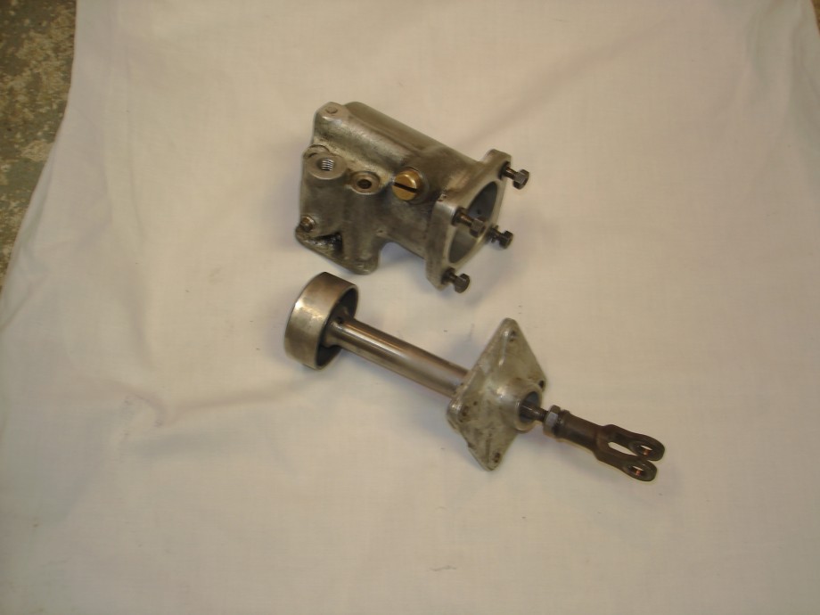

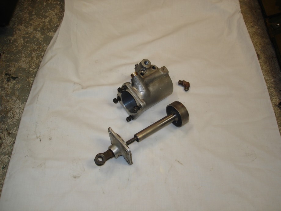

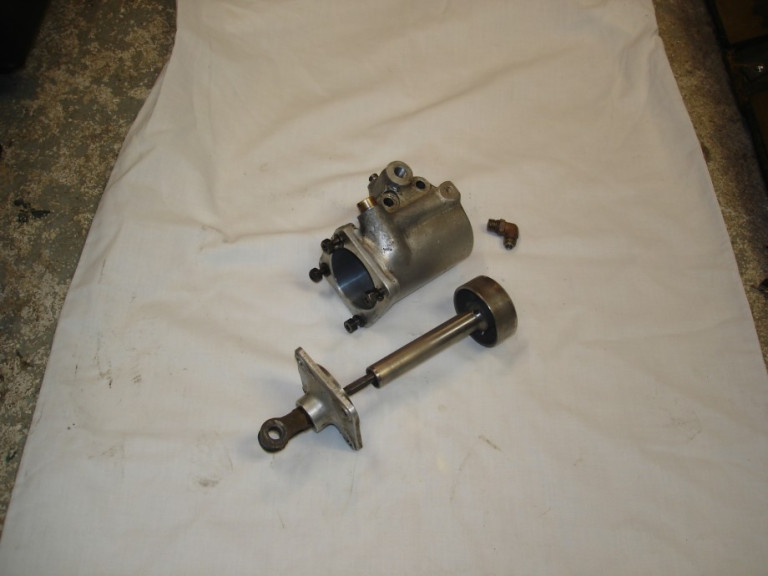

  2. Disconnect the lubrication pipe to the drip plug on the damper dashpot.
  3. Remove the pneumatic ‘dashpot’ damper ‘Td’. Undo two ¼ BSF nuts and uncouple the slotted fork from lever system ‘T’.

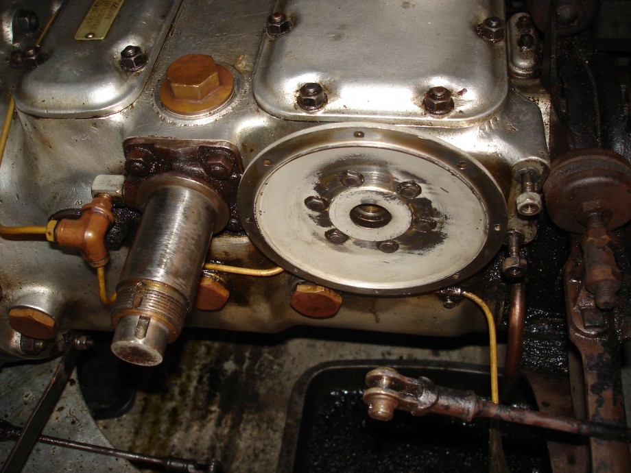

  1. Undo eight – 3/16 BSF nuts on servo periphery. Rotate the servo to bring them in turn into an accessible position by hand turning the jacked-up rear wheel.
Note: The bolts have heads which are assymetrical and thus they need to be carefully orientated on reassembly.

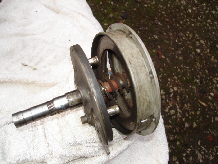

NB. DO NOT withdraw Driving plate which backs onto gearbox. Its shaft can drop a distance piece into the gearbox if withdrawn more than, say, ½ inch. It is suggested that a wire through one of the peripheral holes can be tied to a suitable fixture to hold the driving plate in position during this and subsequent operations.
  1. Prise drum free of driving plate.
  2. Undo 5/8 BSF nut holding rear ( small) end of Bridge Supporting Plate.
  3. Prise out the flanged tube surrounding the stud

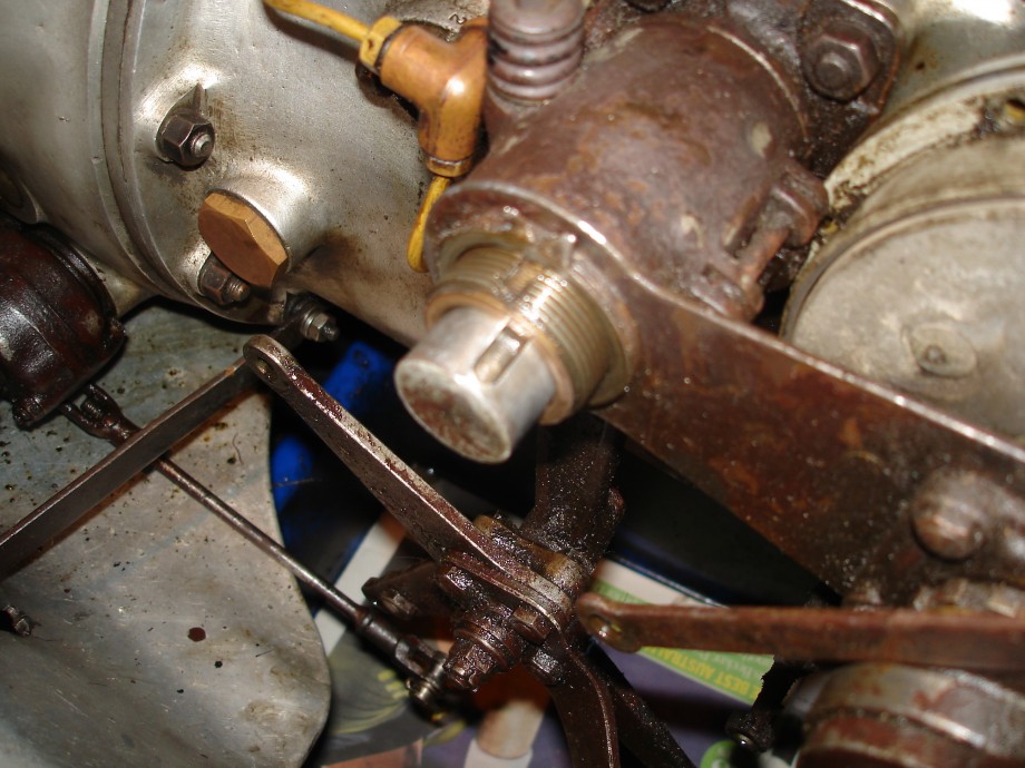

  4. At Cross-shaft end undo and withdraw clamping bolt and withdraw lever from shaft taking care to save the small key.
  1. Undo large , 1- 1/8 BSF, nut holding forward (large) end of the Bridge supporting plate via a tab washer and spacer.
  2. The spring and bolt assy, Ts, which clamps the T1 boss can now be released and removed. Cross-shaft components removed Fig. brake-servo-07.jpg
  3. Draw off complete Servo assembly and ‘T1’ together.
The ‘T1’ assembly can now be separated and cleaned before putting to one side.

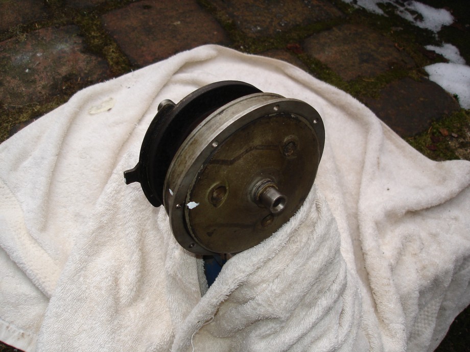

The servo assembly can also benefit from a cursory clean before disassembly.

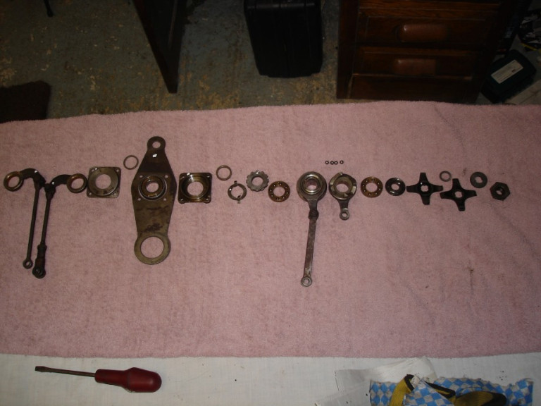

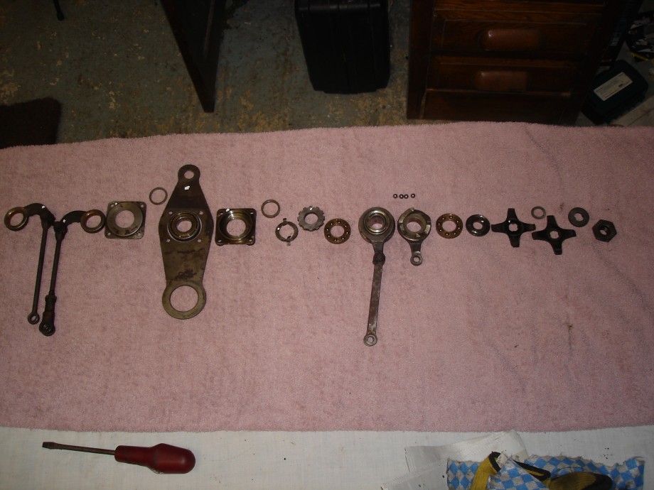

Disassembly of Servo

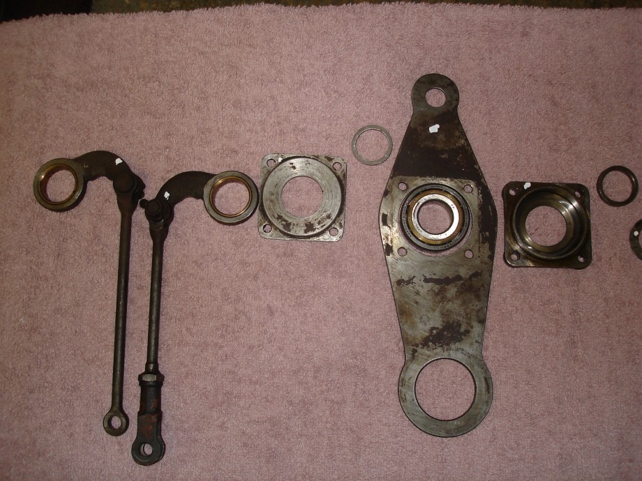

The Servo assembly comprises a series of components mounted along two concentric shafts where the spacing and orientation of each item is important. It is helpful to mark one side of each component with Tippex, or similar and to carry out the disassembly over a large container, such as a seed tray, that would retain any parts which are dropped etc.
In order to maintain the order for ease of reassembly it is recommended that a length of stiff wire is used to hold the parts removed. A right angle bend at the end of the wire will prevent loss of the parts. Alternatively the parts can be laid out in order on an uncluttered table.
Complete set of servo shaft components Fig: brake-servo-09.jpg
Procedure:

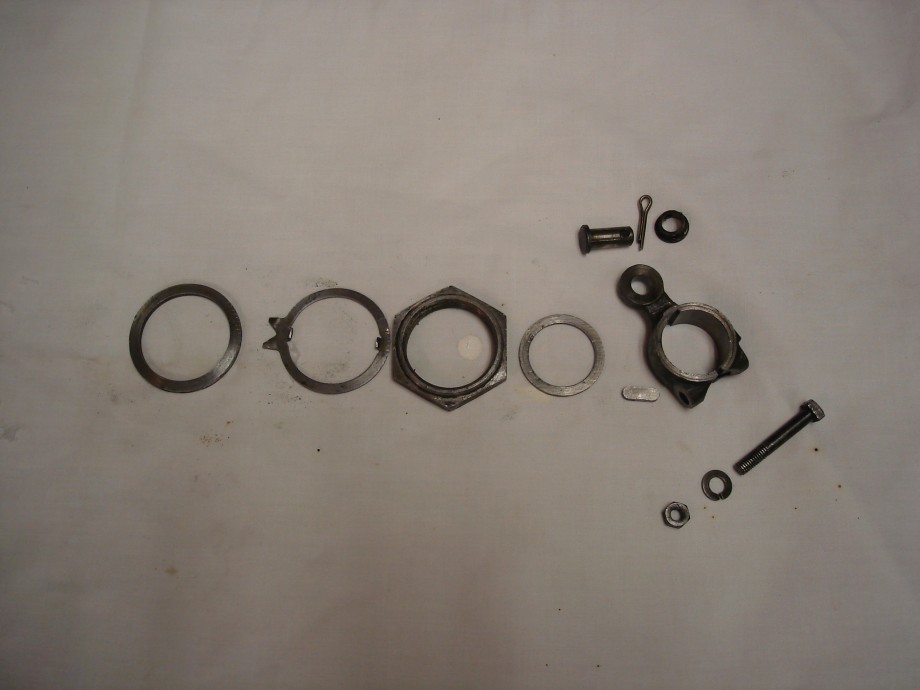

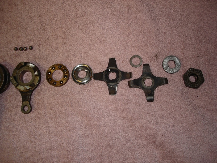

1.Remove circlip at end of shaft and carefully save.
2.Unscrew the large retaining nut which has serrations on its inside face
3.Pull off serrated washer

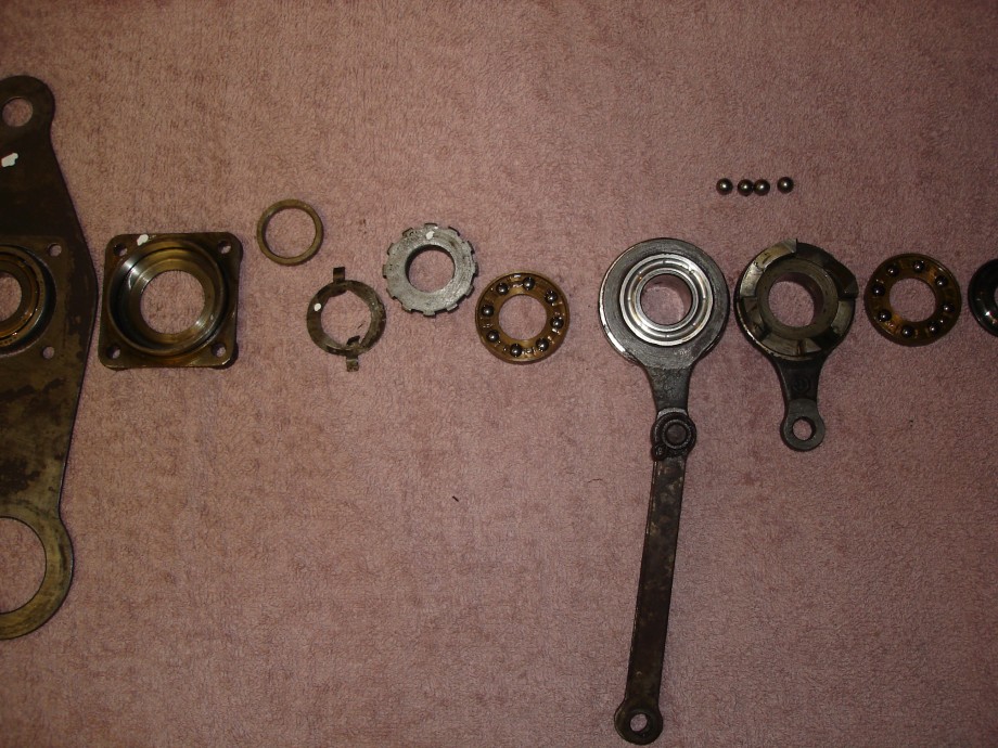

4.Remove buffer springs and keep them in correct order. They have internal tabs which engage with slots in the shaft.
5.A spacer washer is located between the pairs of springs
6.Slide off the washer/ball race
7.followed by the first ball cage complete with its captive balls
8.Remove the cam levers A1 and A2 as a pair.
9.Separate the two levers with great care to save the four uncaged balls located between them.
10.Next remove the second ball cage with its captive balls.
11.This is followed by a castellated ring nut with a ball race machined in its outer face.
12.A tab washer behind it needs to be bent back before the nut can be rotated.
13.A spacer washer sits behind the tab washer
14.The Bridge Support Plate on my 25/30 is sandwiched between the housings of a lovely Hoffman ball bearing. (Note: On some other models this bearing is a simple bronze bush).
If it has a ball bearing then it may be necessary to file the peened ends of the four 3/16’’ BSF bolts clamping the housings, to allow them to be undone and the bearing removed.
15.This finally leaves the two lever arms ‘R’ and ‘F’ to be removed complete with their bronze bushes.

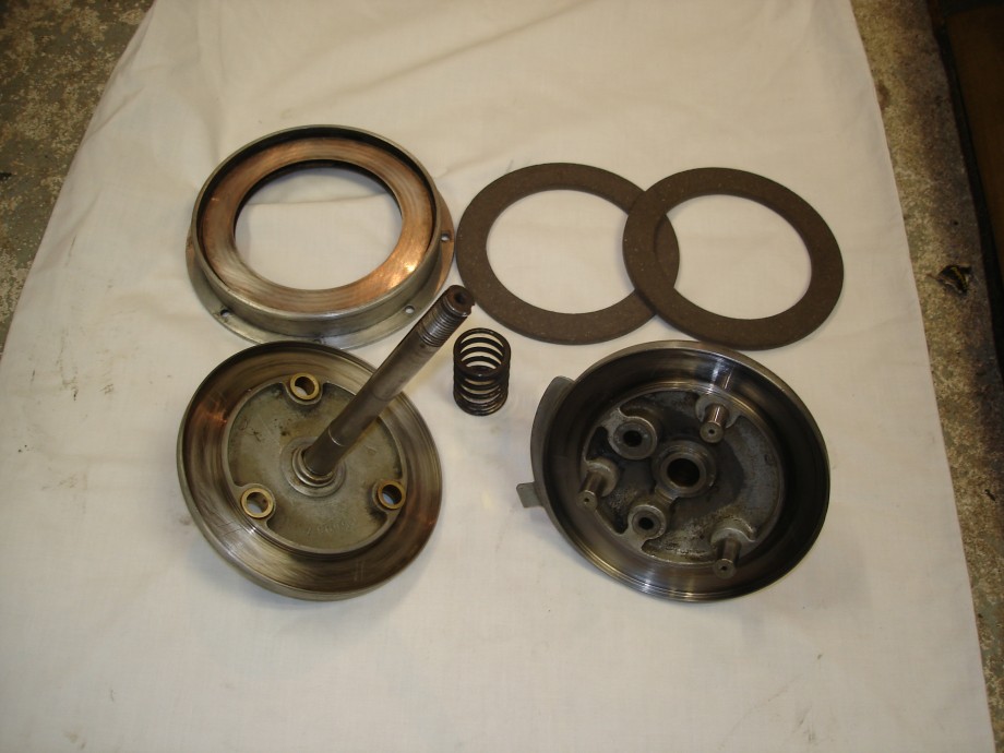

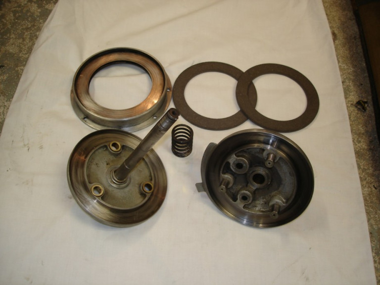

16.The Servo itself can now be separated to reveal the friction linings and faces.
Two views of friction components separated Figs. brake-servo-13.jpg & brake-servo-14.jpg
Friction Linings
On 20hp, 20/25 up to chassis GBJ1 and Bentley 3-1/2 up to chassis B-2-DG the linings are stapled to the drive plates. On all cars thereafter the linings are ‘free floating’.
Note: The early style stapled lining types are easily converted to accept free floating linings by filling the staple holes in the inner and outer drive plates with solder or epoxy filler.
It is likely that the two Ferodo type friction linings and their four faces will have become glazed or oil contaminated by use. Before replacing the friction linings with new components the steel faces on which they bear must be refinished with a fine emery, scotchbrite or similar, to restore an appropriate level of roughness. Alternatively valve grinding paste can be used with the old linings as a carrier to roughen the surfaces. Meticulous cleaning afterwards will then be necessary.
Replacement linings are available from the usual sources and the dimensions will need to be checked to ensure they are a snug but free rotational fit in the recesses and that they have a degree of ‘float’. Any excess on the OD can be removed on a lathe or a file.
Note: Although the modern replacement linings are now asbestos free, it is suggested that a mask be worn when working with friction materials.

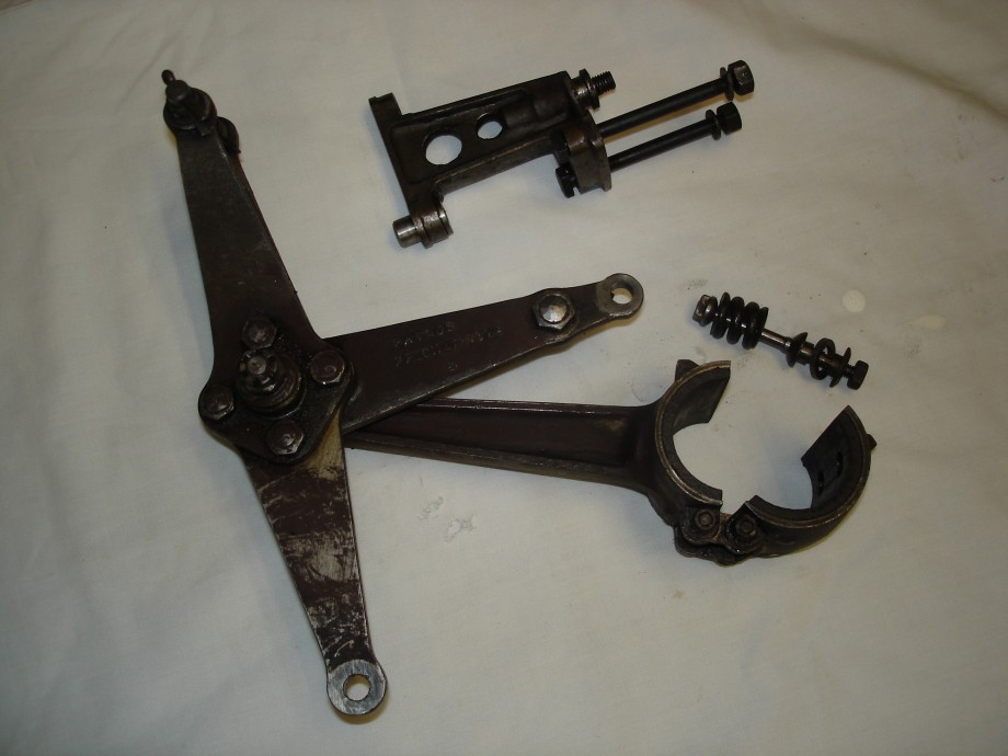

1.The Suspension link T1, which has a friction lined and split boss, needs to be loosely positioned with a wire around the unclamped boss to hold it together.
Note: The cross shaft should be lubricated with engine oil prior to assembly. Thereafter it will be oiled by the chassis lubrication system

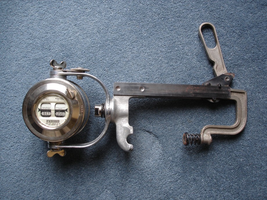

Testing of Braking System
Due to its configuration the Rolls-Royce system cannot be tested for braking efficiency by an M.O.T. type ‘rolling road’. It is therefore recommended that a Ferodo Tapley Meter is clamped to the running board to measure the efficiency whilst on the road.

See: Handbook Fig. ‘The Servo Motor and its Connections’ Fig. RRservo.jpg
See Figures 1 to 5 in ‘ServoFigs.jpg’

  1. Jack up one rear wheel.
Damper dashpot in two views Figs. DSC06626/7
  1. Detach slotted fork on ‘Tr’ from ‘T’.
  2. Slacken 5/16 BSF locknut at rear end of ‘Tr’. Rotate rod ‘Tr’ to unscrew.
NB. Count the turns and note so that it can later be reassembled in same position.
  1. Disconnect base of coupling rods ‘R’ & ‘F’ from ‘T’ but leave attached at top.
NB. Note differences. ‘R’ has an eye at the base. ‘F’ a slotted fork
Reassemble these before ‘Tf’.
  1. Release links ‘A’ by removal of clevis pin from cross-shaft lever.
  2. Detach rear brake rod ‘A3’ from ‘A2’.
  3. and ‘Tf’ from base of ‘T’.
Cross-shaft, part exposed Fig. DSC06608
  2. The spring and bolt assy, Ts, which clamps the T1 boss can now be released and removed. Cross-shaft components removed Fig. DSC06616

Servo Driving Plate and Cross-shaft Fig. DSC06612
Complete set of servo shaft components Figs: DSC06631
Close-up of inboard components 06632
Close-up of mid components 06633
Close-up of outboard components 06634
Procedure:
Two views of friction components separated Figs. DSC06620/1
Friction Linings
Servo unit friction components Fig. DSC06623

The three ball bearings, one a complete unit and the two cages and balls, will benefit from thorough cleaning with a solvent and, if possible treatment by immersion in a degreaser, such as Jizer, followed by brake & clutch cleaning fluid in an ultrasonic bath to remove all traces of contamination. The bearings should then be dried and spun with some engine oil before packing with grease prior to reassembly in the system.

1.Place the new friction linings into their recesses in the inboard and outboard servo discs and reassemble the discs together with the friction plate and the helical rebound spring.
2.Ensure that the three pins fixed to the outboard driving plate move freely in the bushes in the inner driven plate. A light smear of wheel bearing grease on the pins will ensure a long service life. (21)
Note: It is suggested that you clamp this disc subassembly together with a C-clamp to overcome the helical spring pressure until the servo has been fully built up.
Suspension link and ‘T’ levers Fig. DSC06618
